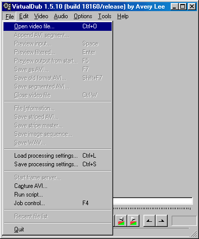

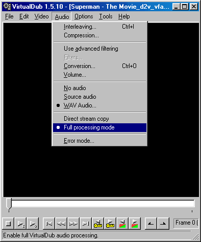

Step 1 (a/b/c)- Click on "File" then "Open video file" and select your source (Such as the Fake AVI you created using VFAPI Converter) file. The Audio is an OPTIONAL step which only
depends on the Encoder you are using, if it only has a single input or it crashes on large
WAV files, only then you use this option! If not, skip to Step 2. Click on the "Audio" menu and Instead of the default "AVI audio" select "WAV Audio", this will cause a "Open WAV File" window to popup, here you select the Audio Track created earlier using DVD2AVI, Click on "Open", then under the "Audio" select the "Full processing mode" option.
a) b)
c)

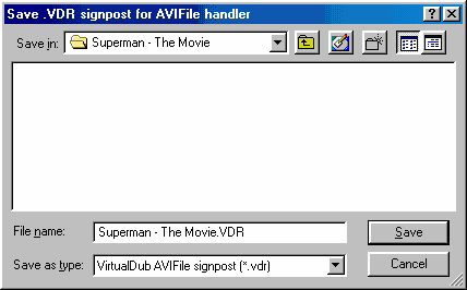

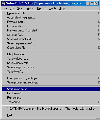

Step 2(a/b) - Click on the "File" menu and then click on "Start frame server..." and when you get the "Frameserver setup" click on "Start"
a)
b)  |
Step 2(c/d) - After you clicked on the "Start" button, you will be asked to save the new frameserved file, make sure you add .VDR at the end of the file, as it is NOT being added automaticly. This will make VirtualDub ready to serve, when you are done with encoding, press on the "Stop serving" button.
