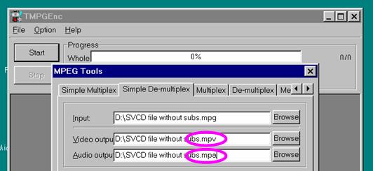

Step 3: De-multiplex
Split (=de-multiplex) the video into a video and an audio stream. Change the ending of the audio from .mp2 to .mpa (replace the 2 by an a), the video's from .m2p to .mpv. Example with the TMPG-De-multiplexer.

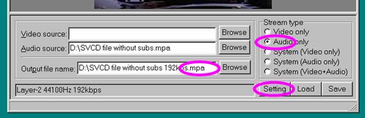

The easiest/fastest method is to reduce the audio rate.
If you have used a standard SVCD template to encode your video the audio rate is probably 224 kbits/sec. Reduce to 192 (use TMPGEnc or other software).
If you get problems later in the process (step 6) (Message from I-Author's multiplexer: "MUX OGT channel 1, first time over" means actually the bit rate is too high), you must repeat step 4 and lower the transfer rate to 160 or even lower.
If you choose to reduce the transfer rate of the video part you have to encode it again.
Example: TMPGEnc, change .mp2 to .mpa, "Audio only", click "Setting", choose bit rate

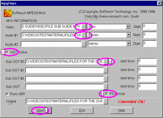

Open I-Author's Multiplexer. Choose your video file (k). Choose your audio file (l). Enable "OGT active" (m). Choose Sub OGT #1 (n), it is the .txt you need. You can add up to four different subtitles (OGT #2, etc.).
If you want to author and/or use any other burning program press "Start" (p). After end process (the "Converted OK!" tells you) continue with I-Authors authoring tool…
If you do not need/want to author but just want to burn the SVCD with NERO: enable "PS format" (o) and press "start" (p). After end process continue with Nero. Nero will protest, but just choose "Turn off standard compliance and continue", it works anyway.
