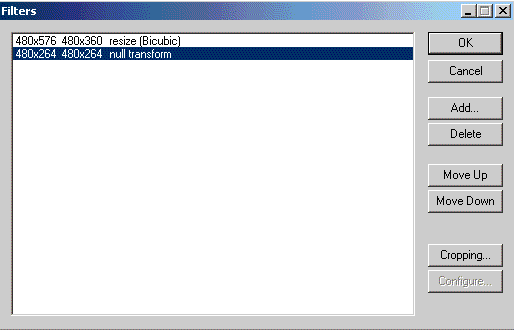

Video
Filters
Under Filters you can add a lots of video filters, if for
example you want to resize the video add the resize filter.
If you want to remove black borders or crop add first the
null transform filter and then click on cropping. If you would
get strange lines in your video add a deinterlace filter.
If you have a SVCD you would have to first
add a resize filter, and resize it to 480
x 360 and if there are any black borders,
add then a null transform filter and click on the cropping
to remove them.
